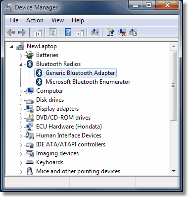

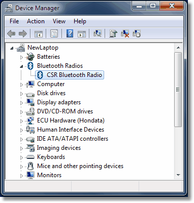

Determining what Bluetooth Stack is in use In Windows open the device manager and expand the 'Bluetooth Radios' entry. Bluetooth Radios using the Microsoft stack show as 'Generic Bluetooth Adapter' whilst radios using other stacks will show the name of the chipset manufacturer.
![]() A Bluetooth Radio using the Microsoft Bluetooth stack
![]() A Bluetooth Radio using a non- Microsoft Bluetooth stack
