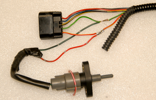

Wiring the sensor We are going to splice the IAT sensor wiring into the AFM wiring. The advantage of splicing the wiring in this way is that it is possible to return the car to AFM use by unplugging the IAT and plugging the AFM back in. You should only have either the IAT or the AFM plugged in, otherwise the ECU will not read the air temperature correctly. You may wish to cover the AFM plug to prevent dirt or water from entering the connector.
On the AFM connector remove the tape and identify the IAT wires. They are both at one end of the connector and are red/yellow and green/black. Strip the insulation back and solder the IAT wiring on. The polarity of the wires is not important - each IAT wire can go either to the red/yellow or green/black wire.
![]() IAT sensor spliced into harness

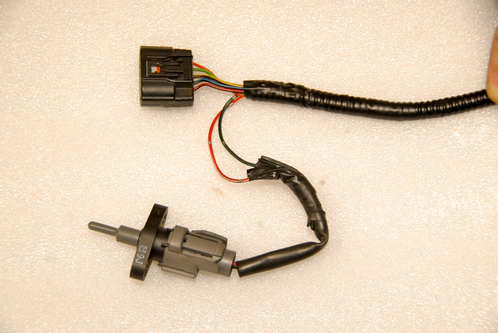

Insulate the connections and replace the plastic wire shield.
![]() Splicing completed

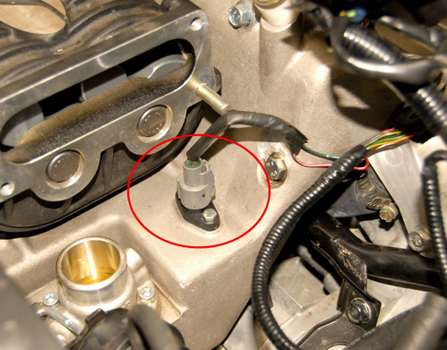

Sensor Placement Place the IAT sensor where it will effectively read the temperature of the air entering the engine. For NA vehicles this is virtually anywhere in the intake tube. For turbo-charged vehicles the sensor should be after the intercooler - near the throttle or in the intake manifold works. Supercharged vehicles should position the sensor so that it reads the air temperature after the supercharger.
![]() IAT sensor in manifold
Before starting the vehicle switch the ignition on and verify by datalogging that the sensor is reading the correct temperature. There are no calibration changes necessary for the new sensor - just make sure you are using a MAP based calibration.
