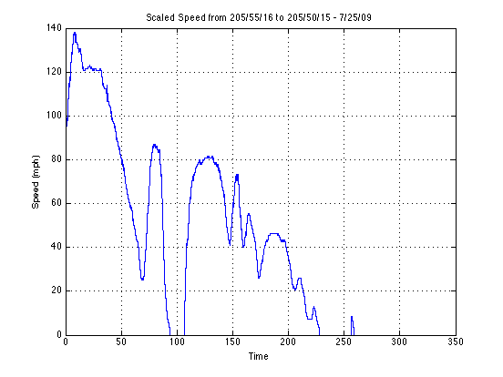

Scaled the speedometer input to account for the different tire size between the Civic and RSX. I'm guessing the speedometer tends to be off at higher speeds anyways though... Image

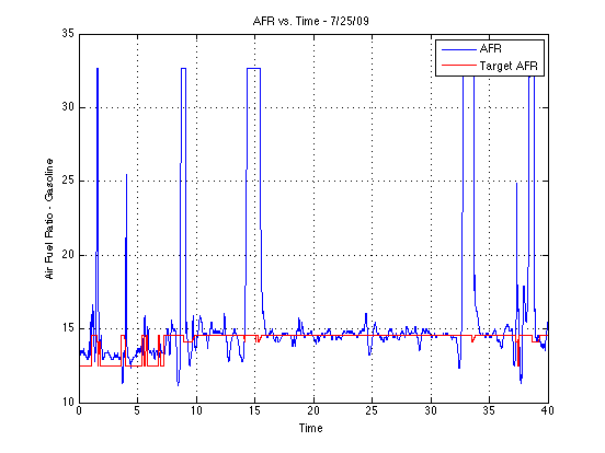

AFR's look good for the base K20 tuned map.

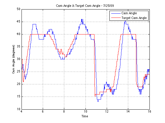

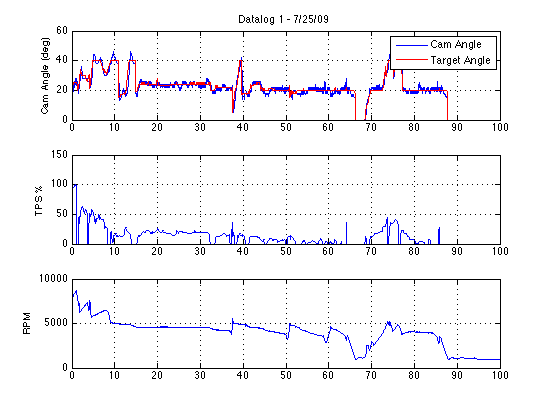

Look at that cam angle go! iVTEC ftw! Image
Honda needs to step it up with the cam angle control though, too much overshoot haha.
I exported data as a .csv file and then made all these plots in MATLAB. I'll probably get around to making a filtering function for it in a few weeks once I'm done with all my shit at school and have some spare time.
