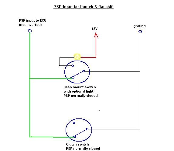

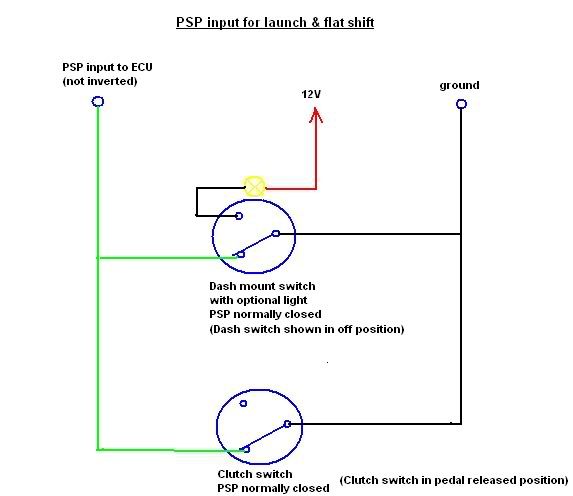

I looked for a solution to my own little idle surge problem(until hondata might please do something about it,lol) & came up with this.XPEHODATA wrote:Why you not fixed increasing idle speed for PSP switch too?Hondata wrote:V1.4.1 (11 March 2009)
• Fixed AC switch increasing idle speed when AC switch used for other purposes.
This involves using PSP for clutch switch input for launch control & flat shift(until i can find a nice little strain gauge solution for flat shift,anybody got any good easy setups to look at???)
The only time i get idle surge now is at the track(or the "track",lol) waiting to race.........problem solved.
Just activate the dash switch when launch or shift needed......pretty little light in switch comes on to tell u it is active.....deal with the little idle surge problem while creeping forward in the staging lanes......race.....turn off dash switch when u r cruising home.
comments,criticism welcome,something i missed???
dont forget to post your nice strain gauge setups for me to copy,cheers
