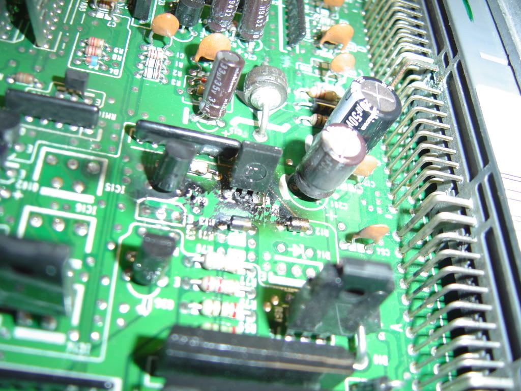

Pulled the top of the ecu and it is crispy. Has no burnt smell and looks like it has been that way for a while. It looks like they soldered a new piece in to fix it but didn't do a good job. You can tell the prongs were soldered by hand and not machine and one prong didn't have any solder on it. got the ecu already installed from a place called Full Throttle in NY. Ordered a new one from someone else today and will be returning this one. Guy on the phone even gave me an attitude about the whole thing.

nice stuff,looks like that ecu spent some of its life in a junkyard anyway.
i wouldnt have a clue,but to anyone more knowledgable,are those burnt out parts an attempted vtec conversion to non vtec ecu?

You might be right. It is a p06 converted. I too have limited knowledge of inside the ecu. But that would answer alot for me. Guy is trying to say it was fine when he sent it but for there to be that much damage and not be able to smell any burnt smell at all makes me wonder. It even looks like some of the burnt soot was wiped away and cleaned. And yea, you like that rust scaling on the inside there huh. Kinda looks like salt deposits.

Nope......thats a fail for me......

Was told by Hondata dealer that burnt up hardware is from someone hooking up the tps and purge valve backwards on engine.
