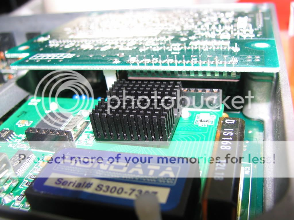

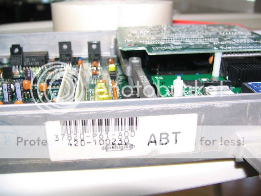

The small board will not fit after hondata s300 install. It's a p61 out of my 92 GSR, This computer is original to the car as far as I know (I have owned the car for since 96. What gives, everythisg I can find says it is supposed to fit. ANY help would be great. Image

It should fit if you remove the white plastic spacer.

The only way it would come close to fitting would be to trim the heatsink on the hondata as there are at least two rows that would have to come out. Then it might fit.
Posts: 24179
Then you will have to trim the heat sink. You have a non-standard knock board in that ECU.
