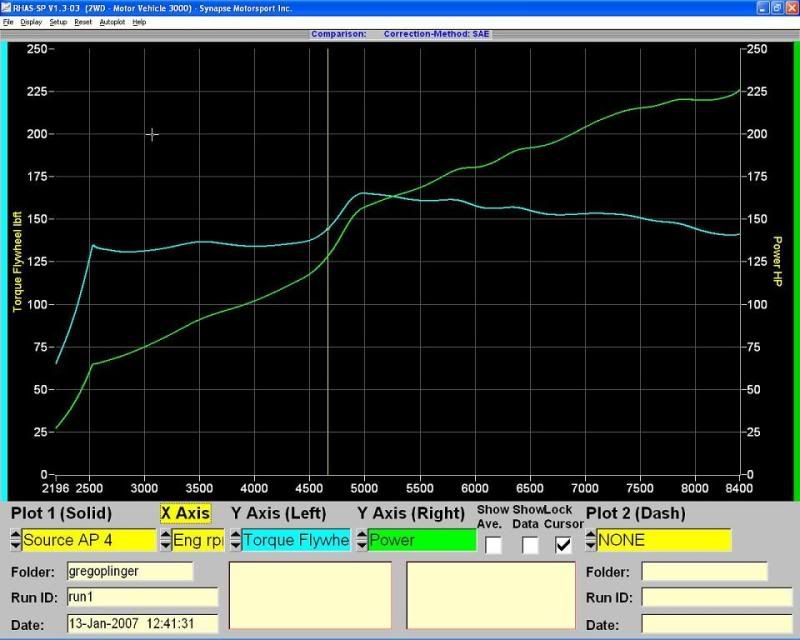

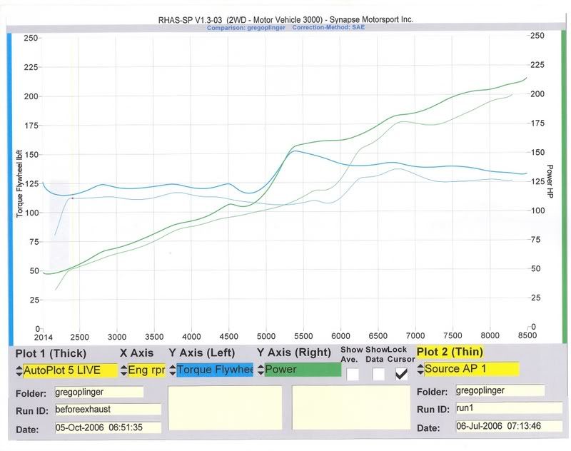

here is a comparison between my .kal & stock ITR .kal (no other changes or mods) FYI this is on a low reading dynapack - I hit 230whp on a dynojet
That's brilliant mate very good figures there and a very close setup,if you can post up that calibration or pm it to me it would be great help! Many thanks

the graph & kal posted I had 3ft of 3" pipe off the header :shock: I think my dynojet 230whp was std not sae
later on I did add a full kteller/burns stainless 3" exh with a 24" resonator & short muffler & made the same power.
eventually (with full 3") I switched IM's to a custom IM & 70mm TB & made 227/166 (gains throughout) - its tough to say which mod the power came from so I will be doing much more testing in the near future :twisted:
NOTE the low cam is not fully tuned on my kal or in the graphs
