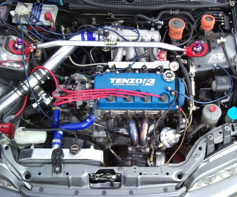

Posts: 24363
Where do you have the sensor mounted?
sIrK
Posts: 28
Joined: Tue May 27, 2008 10:38 am
Location: Barcelona
Post by sIrK »
Spunkster wrote:Where do you have the sensor mounted?
In the throttle body with 2 screws, like the stock map sensor.
Pic of my Engine, you can see the sensor:
