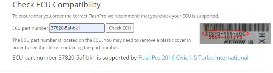

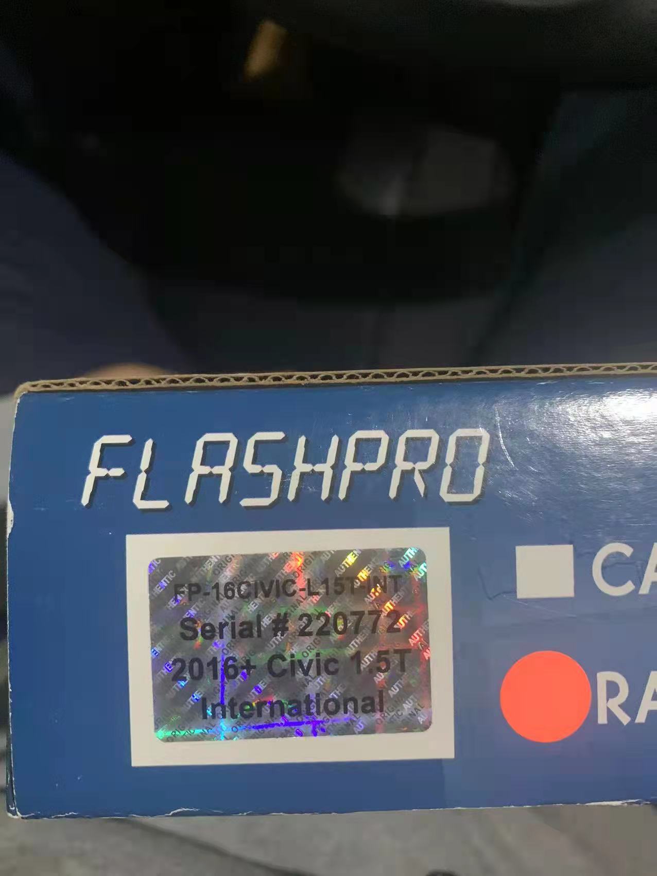

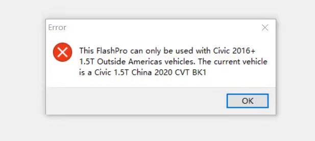

I can't lock my hondata flashpro to my vehicle. My vehicle is the 2020 China hatch cvt. I've sent email to hondata for so many times but got no reply,even one email back.
I can check my ecu id on the website and it says my id is supported by flashpro 2016 civic 1.5 turbo international which is exactly my flashpro is.
Pleas help me fix this issue. It has been a few months and I can't use my flashpro. Please help me fix it. I try it on every version of flashpro manager even the latest 3.9.2. It doesn't work. I don't know how to do.
my ecu id is 37820-5AF-BK1

We have not received any emails from you, but we can look into this now.

Fixed in the release yesterday
