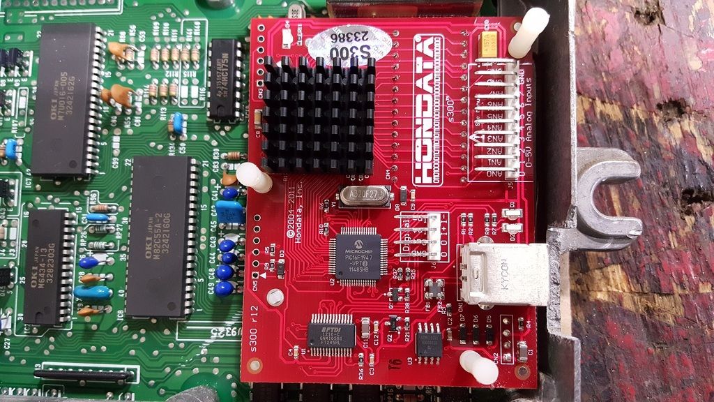

What is the serial number that is on the s300 board inside the ECU?

I'm not sure where the s/n is or is it the 23386?
