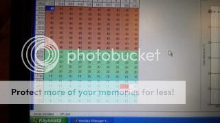

Folks, having an issue viewing Lambda Values and Fuel Adjustment Values in KManager v3.3.1.0. I'm using a the built in wideband as my AEM is not wired to the ECU. I can datalog, upload maps etc however no data is being populated in the specified tables (see image below). I can see the points moving around on the table when I hit the gas, but for some reason it's not showing any data.
The car is a JDM DC5 Type R, using a K-Pro v2. Also I set the minimum TPS value to 0% instead of default 4%, but that didn't work either. I've uploaded a .kal file with the tweaked basemap that I'm using for now.

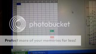

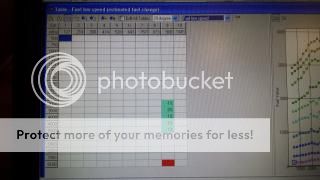

If cam angle is locked then it should be in the same cam angle. Right?
It usually show low cam afrs but on high cam only 1 value on cam 20 and 1 value on cam 10.
Nothing in cam 40.

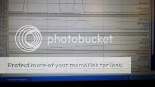

In last picture afr is green line in lowest box so its recorder normally to graph.
