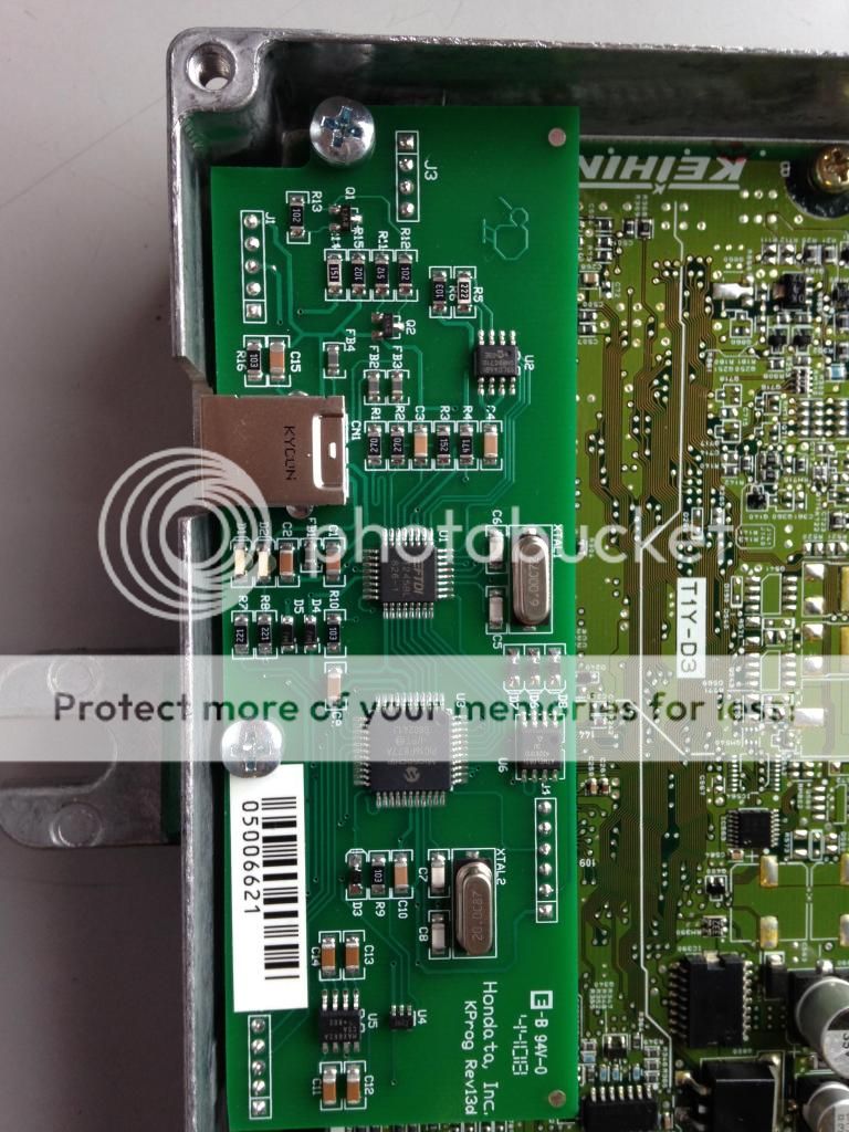

Post a picture of the inside of the ECU showing the K-Pro board.
cutsheal5
Posts: 11
Joined: Wed Mar 26, 2014 1:46 pm
Re: CEL and limp mode no codes
Post by cutsheal5 »
Posts: 24386
Send an email to support <at> hondata.com with the following and I will issue an RMA and give you further
instructions (include a link to this thread):
Name:
Address:
Phone:
Email:
Serial#:
Description of problem:
