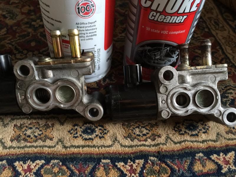

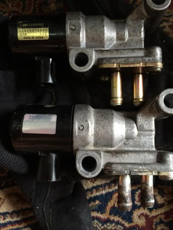

I got an IACV off a 98 Integra LS from the junkyard (according to the Acura part numbers all 96-01 Integra IACV should be the same). Unfortunately, the Denso sticker is worn so I can't verify that it says 6TA on the second row of numbers. The inner diameter of the left air hole is a little smaller on the one I got from the junkyard. I cleaned it and put on a new gasket, and my car now runs the same from the "normal" to all the way decrease of the IACV duty cycle. It is still idling high, at like 1500 RPM. So with my old IACV, my idle was steady at 1500 RPM only when the IACV duty cycle was all the way decreased and it was surging on normal. Now with the new IACV, the idle is steady at 1500 RPM anywhere from all the way decrease up to normal, but when I increase it more it begins to surge.

You see how the diameter of the air hole on the left is a little larger (on the left IACV, which is off my 96 JDM Integra Type R motor).
