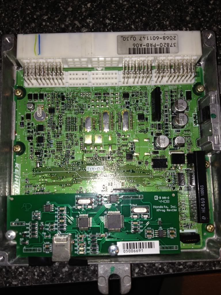

Damn, problem came back this afternoon, all ground are good...
Posts: 24179
Re: Check engine stays on without USB plugged
Post a picture of the corrosion in the ECU
zaknafein
Posts: 10
Joined: Tue Jul 30, 2013 10:11 am
Post by zaknafein »

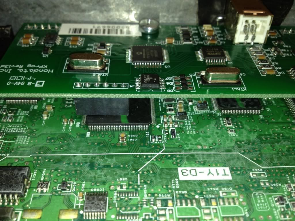

Corrosion wasn't really that bad, I work at a Honda dealership and my tech told me he saw really worse things working fine, we cleaned that up anyway. it doesn't seem to be the problem.
I don't have any "before" picture, but there was only a little stuff around the edges of the processors on the PRB board under the Hondata board, Hondata board is like new.
Posts: 24179
Have you tried it in another vehicle?
On an ECU with corrosion on the inside of the ECU, especially the processors, we weill not even install a K-Pro. This was installed by one of our dealers, so you may want to discuss this with them (Synoptic Tuning). The ECU will probably have to be replaced, as once corrosion starts it will continue forever especially when there is electrical current.
