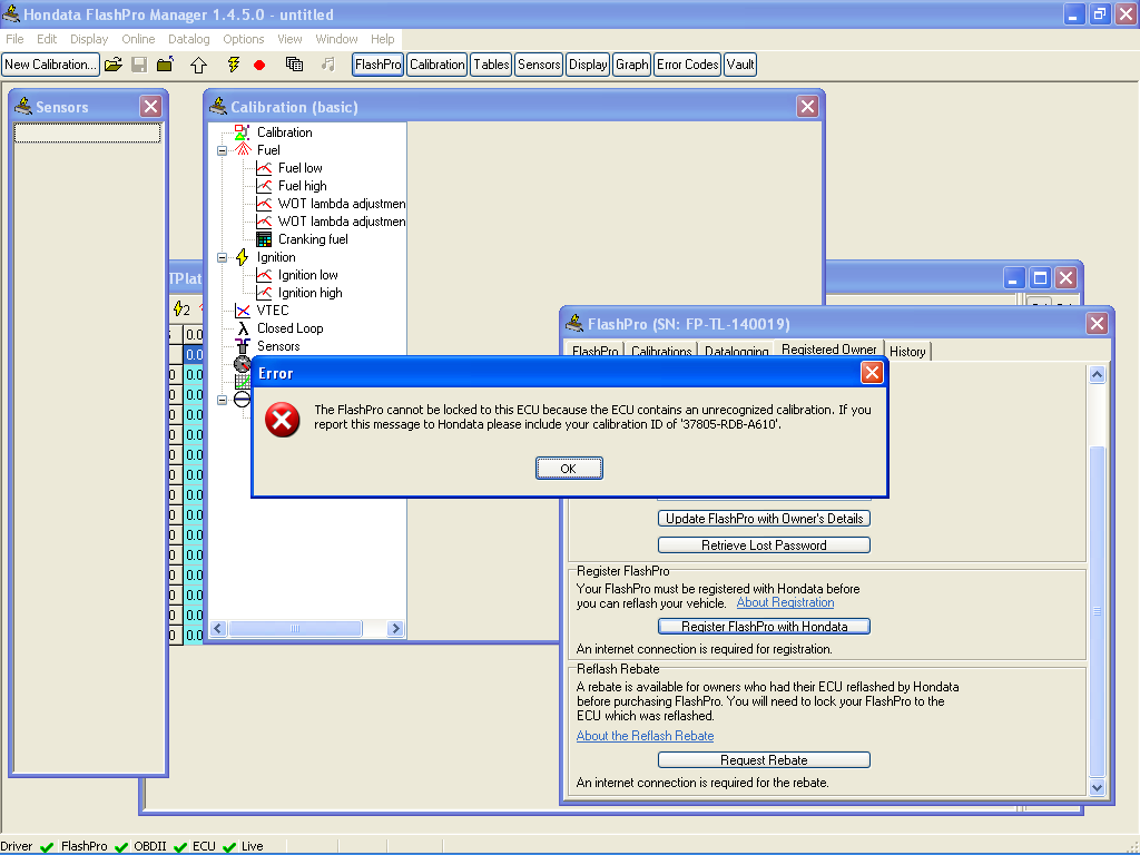

i was unable to lock a new flashpro to an 08 tl-s auto today. i was given this information:
is there a known problem with this ecu? the flashpro serial number is 40019. i tried two different computers and came up with the same error each time. i also tried most of the other tl calibrations with the same result. also, the registered owners information fields kept getting replaced with a very long string of random characters. what is the recommended next step?

If you want to, you can send us the FlashPro and we can update the firmware and you can then use it with the current software. We are in the midst of changing compilers for our software and this is what is causing the delay in a new version of software. If you wish to send this in instead of waiting on the new version of software please let me know via email (support <at> hondata.com) so I can issue an RMA and further instructions.
