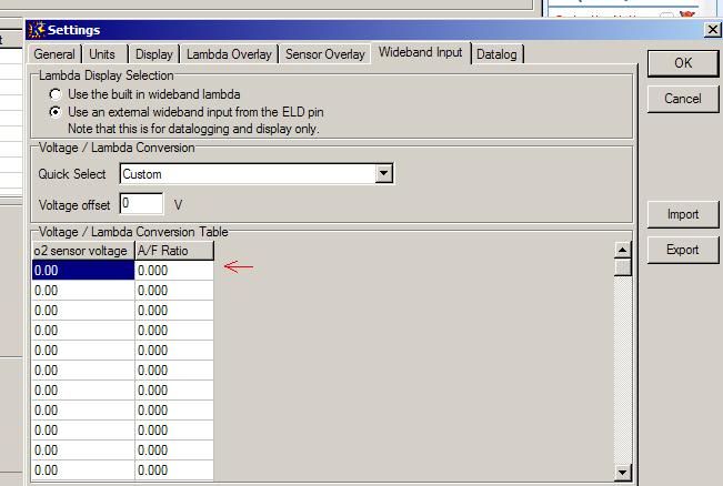

Problem:
When I am doing a live datalog recording the A/F constantly shows 0(On K-Manager). When I replay a recorded datalog, it constantly shows 14.7? Is there a setting that must be changed since the wideband is connected to the ELD?
Posts: 24179
Re: A/F readings
Go to Options, settings, Wideband Input and make sure you have it set correctly there for your wideband.

Does anyone have the conversion table (or diy) for the LC-1? I looked through the users manual and the innovate website couldn't find the values.
Posts: 24179
Re: A/F readings
You will need to contact the manufacturer of the wideband for the calibration info.

Ok, so I called Innovate's tech support and they said the LC-1 has no voltage conversion table as it is linear.
He just gave me the info:
0v - 7.35
5v - 22.39
Do I still put these numbers here? How about the offset?
Posts: 24179
Re: A/F readings
He gave you the voltage conversion table. Enter that, then adjust the offset until it reads the same in our software and from the wideband software or gauge.

Do I start with increments of 1v? I don't want to damage the wideband or ECU.
Posts: 24179
Re: A/F readings
Enter exactly what they gave you.
