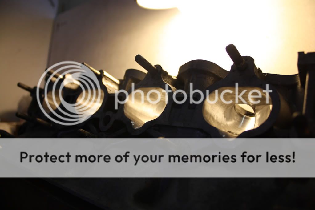

Head porting is about a stage 2 or 3, the valve guides are ground down, this is what it looks like...
