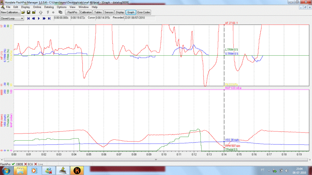

Yours sounds like a fuel trim issue.ajpturbopittsburgh wrote:I have seen a drop in rpms when I sit in traffic with and without the A/C on. It sounds like it may stall but it recovers and never does. I have driven the car plenty so it shouldn't be learning idle anymore, correct?
Sorry I don't have a data log
