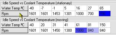

What i dont understand is that all the base cals in Smanager(& hence what appears in most peoples cals atm),the Stationary idle speed versus coolant temp tables are all messed up,the temp values are all too low(seems they have all been corrupted),so how does the idle read higher at lower ECT temps???
Does this table still work anymore???
Is this what u see as i show below,notice the temp values top out at 65degC,when they should really be the same as the table below topping out at 150degC?

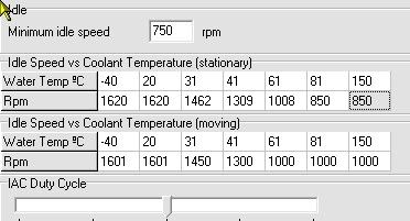

yes u can change the temp values on the stationary table to reflect whats shown on the moving idle table above,thats how they should be(or there abouts),i assume yours will read degF however depending where your from.

I checked my idle settings today at lunch and noticed that my stationary idle speed vs coolant values match your values but I am in *F . This is what I have
idles speed vs coolant Temp (stationary)
Water Temp *F - -40 20 31 41 60 81 150
RPM 1601 1601 1453 1301 1000 700 700
(moving)
Water Temp *F - -40 67 87 106 141 177 302
The RPM's are about the same as the stationary values
302 *F = 150*C. It appears that the values entered into the stationary cal. are for Celsius. So, should I set my stationary water temp to match the moving still?

Yes they should have the same temp values(the moving table values being the correct values).Heres my cal as an example if it makes it clearer(obviously your rpm values may vary,but its the temperature values im trying to point out)
The full operating temp stationary idle rpm will apparently not be affected as ive been informed the ECU will just read the last known values as it runs off the end of the table + u probably have a minimum idle speed setting which is higher than those values anyway(entered above the 2 tables).
Its just the warm-up rpm values that will be affected as u will see the ECU will settle to 700 rpms(or whatever your minimum idle speed setting is) by the time it hits 81degF(way below full operating temps),in your cal.
