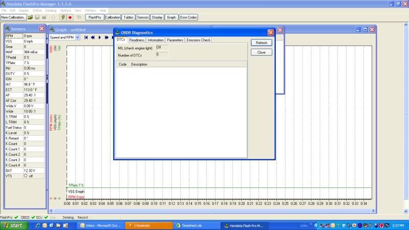

I had a CEL for a couple days, so I hooked up the FlashPro to check the codes. Unfortunately, the CEL must have just turned off.
However, when I went to Online -> OBDII diagnostics, FlashPro Manager showed me that there were 5 DTC's, but would NOT tell me what they were! I clicked Refresh several times, but the list just stays blank. I can see OBDII data on the other tabs, like RPM, temps, etc., but I can't figure out how to get it to tell me what the 5 DTC's are!
I see above that maybe I should try clicking the Datalog button before viewing them, but that just seems kind of weird.

I went back to try it again while datalogging, and it didn't help. I still can't figure out what the DTC's are from.

Posts: 24386
You have to datalog and click on the error codes window.

Post by Gernby »
Spunkster wrote:You have to datalog and click on the error codes window.
I did do that. In fact, if you look at the image above, you can see part of the Error Codes window right behind the OBDII diagnostics window, and right behind that is the Graphs window, which was capturing a datalog as I clicked Print-Screen.
