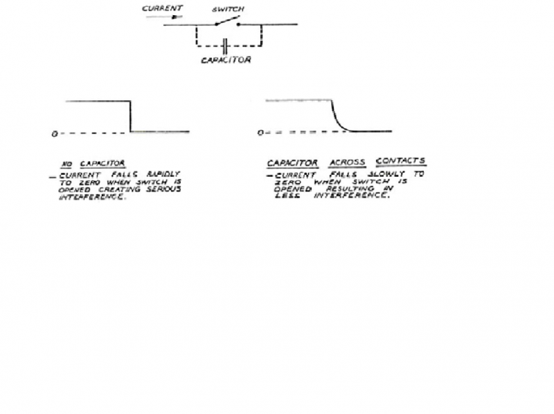

Stock fan swapped in and issue stopped . It only happens with my Spal high cfm unit . I am going to try a capacitor across the fan terminals .
Re: When the Fan turns off the ECU disconnects.
This is what I was planning on trying. Trying to not go back to the stock fan. I have an extra mishimoto fan sitting around, but I cut the shroud to fit the SPAL fan.joeb wrote: I am going to try a capacitor across the fan terminals .
