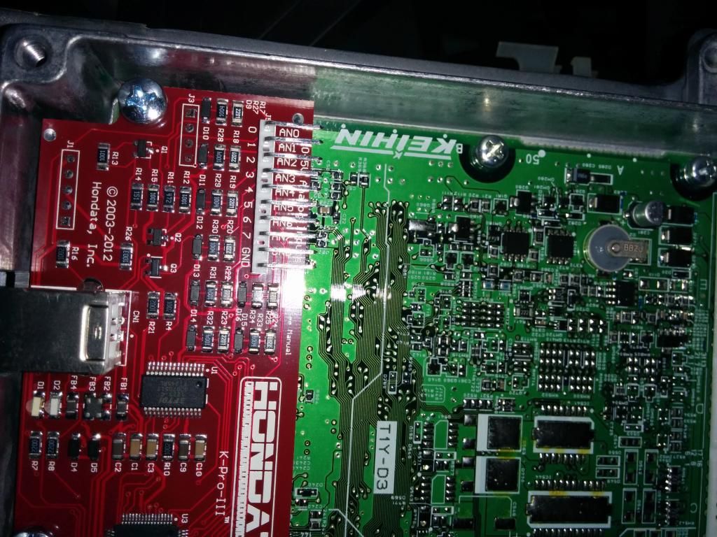

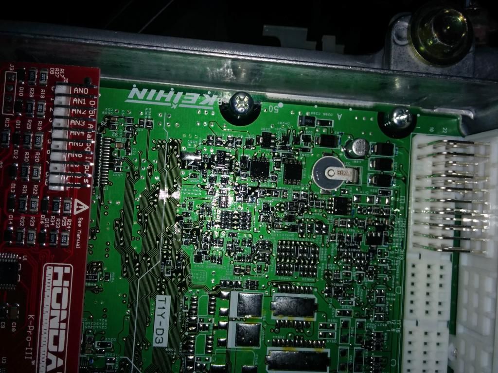

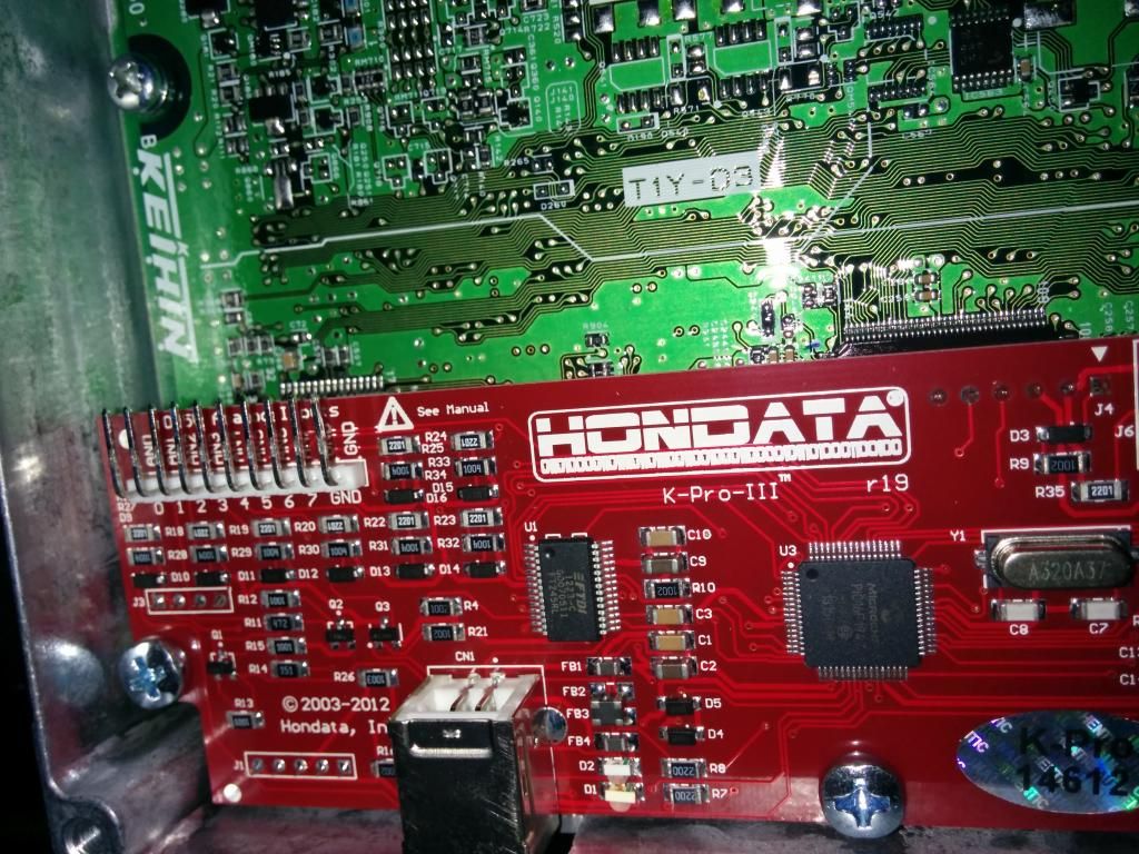

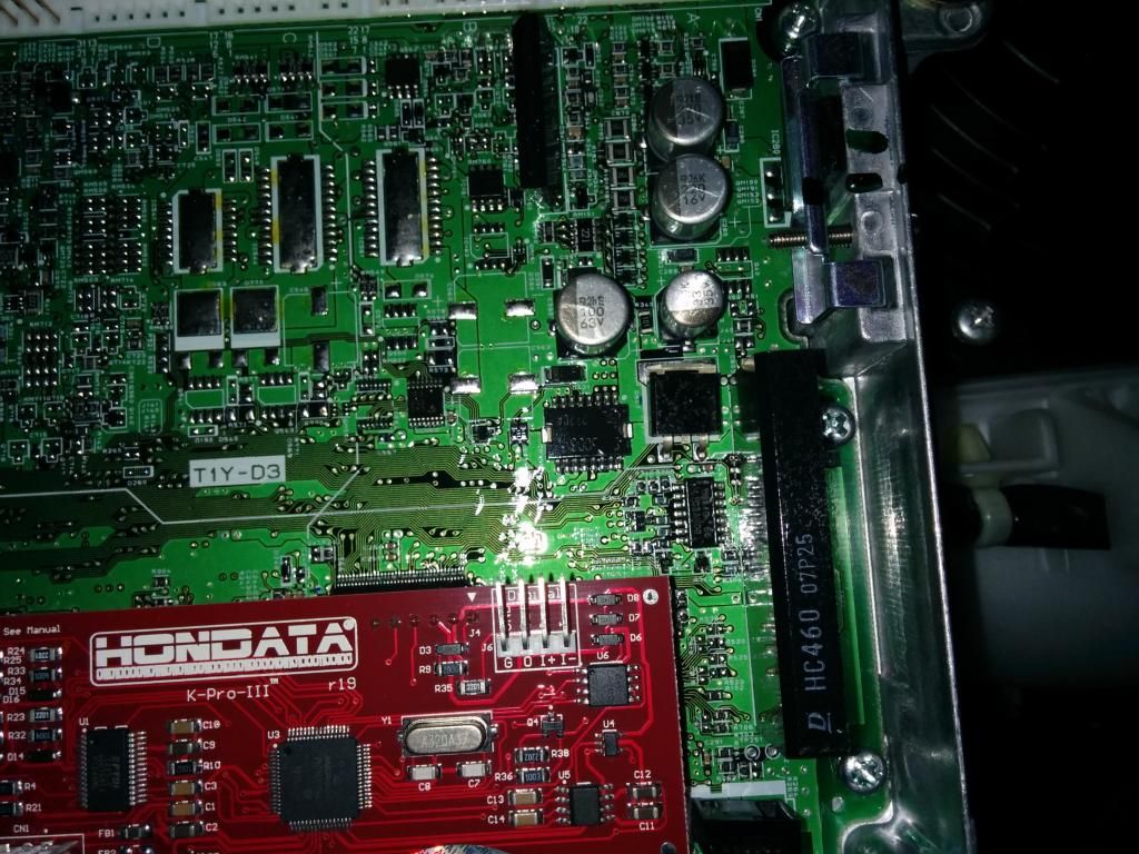

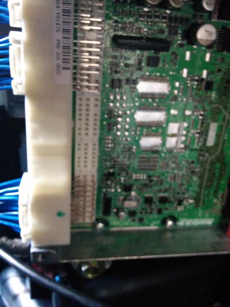

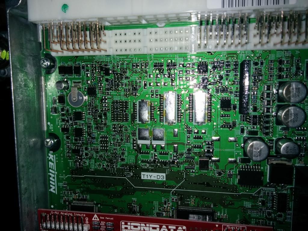

Take a high resolution picture of the inside of the ECU. Make sure it is in focus and post it here.

Forgive me for the spam. But I'm leaving for work for the next 10 days, so I snapped a whole bunch. Are these what you need?

The ECU appears to be prepared correctly for in 05/06 RSX.
