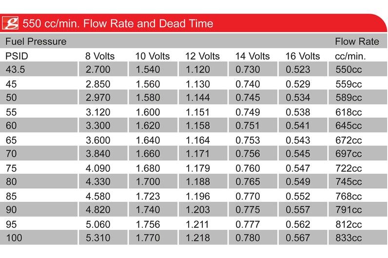

Getting quite a large AFR change as i turn on the lights, interior blower, stereo & rear screen demister. As i add load to the system the mixture leans out going from 12:1 right down to 15:1 roughly.
I've added the dead times supplied by grams for the 550cc injectors (see below) which didnt help. Ive also added some more grounds in the engine bay.

Try adjusting your dead times so until you get no change in fuel when the lights are on.
