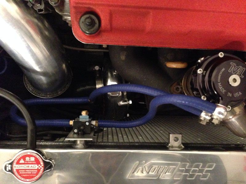

Post your calibration and check your hose connections because you should be getting a lot more boost than that at 80%.

These are my hose connections - already checked for blockages.
