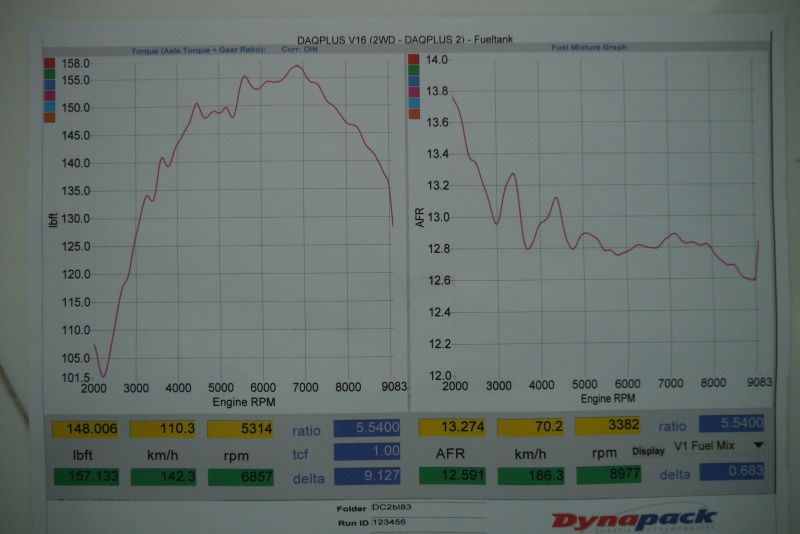

Finally got my car tuned today. Got 233hp and 157trq. Seems a bit low? Here are the specs.

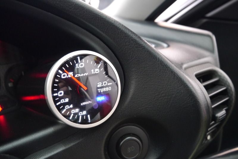

7.5 psi (ecu read 0.5 bar (7.5psi), but the boost gauge read 0.6, I guess the ecu is more accurate?)

The dyno graph was DIN corrected instead of SAE you guys use stateside. I trasferred it to SAE corrected at the end and it was at 244/166.
Whats the difference between SAE and DIN?
What is the TCF ratio?
Also, what IAT do you guys see? Past 7,000rpm, my IAT goes up to around 140 deg F.
When SAE corrected, the HP seems close, but torque seems a bit low.
Maybe its my twin loop muffler being restrictive? Maybe the temperatures, humidity? Any thoughts?

Posts: 24170
Re: JDm B18C LHT JRSC @ 9psi
Temp and humidity are what is causing the most lost of power.
The temps you are seeing at high RPM are normal, but the temps should drop quickly after the run with the LHT.

The temps don't really drop that much. During runs, the iat gets up to 140 (saw 145 max). And after the run, it drops to around 120 only. Maybe its the temperature and humidity here.

Doesnt say how DIN compares to SAE.
Posts: 24170
120 degrees seems right for the temp outside.
