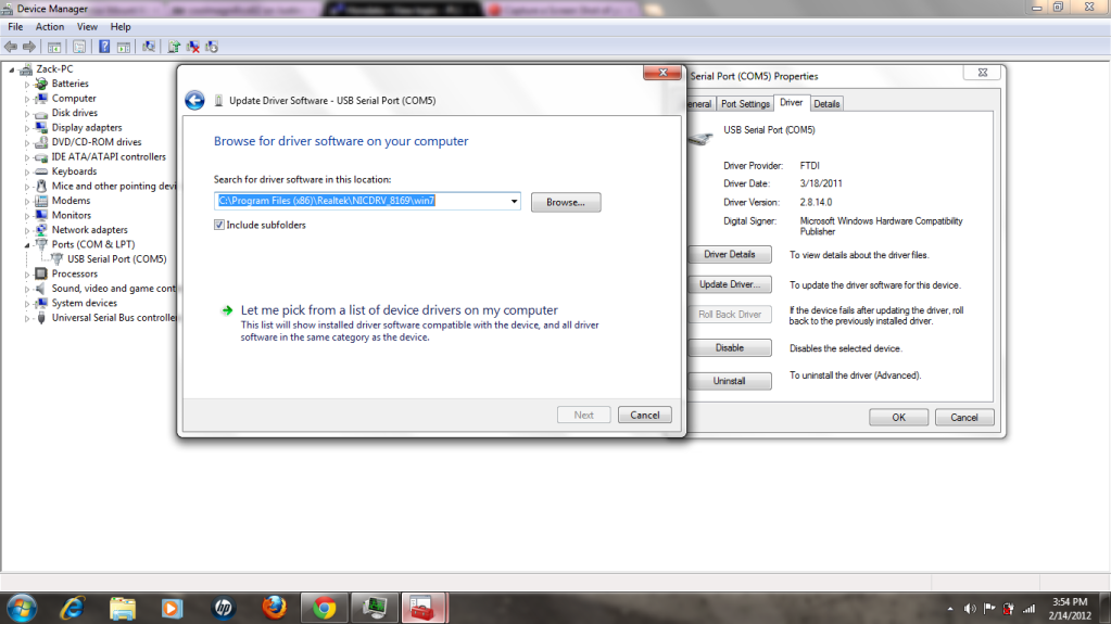

OK i redid it and follwed instructions step by step... The problem is im getting stuck at the part where im supposed to browse for the driver software... It should pop up ( C:\Program Files (x86)\KManager ) But it doesn't. Also there is nothing through out the instructions on my computer recognizing it as hondata or k pro ecu ect...

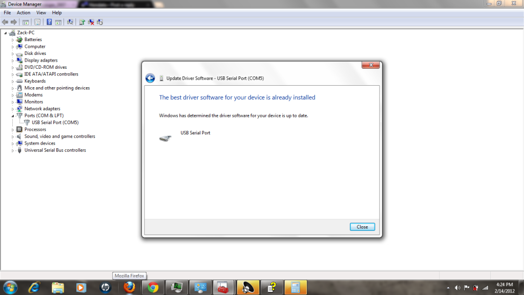

In the device manager its just under "Ports(COM & LPT)" and Its just saying its "USB serial Port (COM5)" Where as in the instructions it says it should be under universal buss controllers, and should say hondata k series ecu.. And mine doesn't... Idk if im making it sound like much sense lol im not to computer savy.. But this seems pretty straight forward and im just not getting anywhere.. Here is a screen shot of what im getting
I then copied and pasted the "(C:\Program Files (x86)\KManager)" in the box where im browsing for driver software. and here is what its saying after that
Please lmk if im doing something wrong or what or what i need to do to fix this i greatly appreciate your help
Thanks,
jordan
Posts: 24176
Re: PLEASE HELP... K pro drivers
You cannot copy and paste the location. You must browse to where you have installed the software like it says in the help file. Is your version of windows 32bit, or 64bit?
