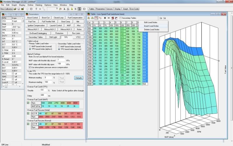

Hey guys, im tuning my ITB's on my b20vtec, and kinda new to the hondata,
and was wondering how do i add a new collumn in the fuel / ignition tables? its pretty frustrating, because i want to get the hole scale on the TPS overview.
like on this table:

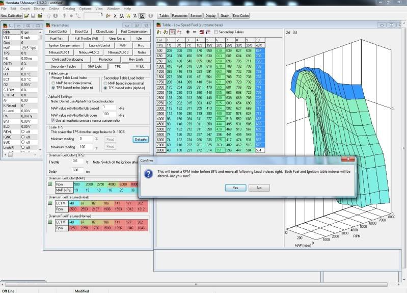

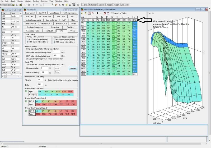

here was my try to add new collumns:
thanks for a quick answer!!!

Options, Show boost tables, then go to http://www.hondata.com/help/smanager/ch ... ert+column to see how to edit the indexes.

Spunkster wrote:Options, Show boost tables, then go to http://www.hondata.com/help/smanager/ch ... ert+column to see how to edit the indexes.
well, i just found out how i got all the way to 100%, by clicking "OPTIONS", "Show 3bar tables"
but i couldn't find out how i insert a new line for the rpm... maximum is 8950 now.
thanks again! :)
