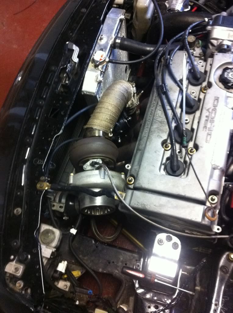

Post by hatrickstu »
Ok here are some pics of the routing so you can see if I'm an idiot. Also, I started the car with the top wastegate line disconnected. Obviously i could only free rev it with no load and no boost but it did not appear to have vacuum or pressure at all. Would load or boost be needed?
As you can see the pressure line is coming from the compresser housing where it splits off to the solenoid (side with only one fitting) and to te bottom of the gate. The other line runs from the top of the gate to the other end of the solenoid (fitting offset on that side, the one in middle of that side is venting to atmosphere). Correct?

Post by AREA876 »
hatrickstu wrote:Ok here are some pics of the routing so you can see if I'm an idiot. Also, I started the car with the top wastegate line disconnected. Obviously i could only free rev it with no load and no boost but it did not appear to have vacuum or pressure at all. Would load or boost be need?
Yes you need boost to see if the solenoid is delivering pressure to the top of the wastegate.
