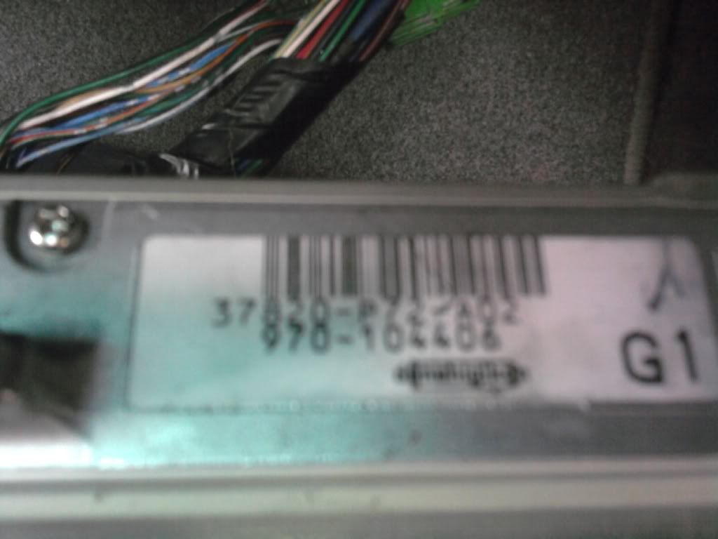

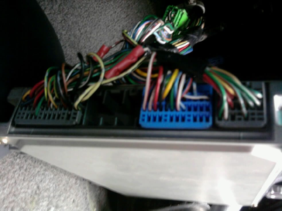

okay so i picked up a 1998 ek dx hatch two days ago and everything is awesome with it. but it throws a check engine light because it is a 1995 gsr swap with a p72 ecu and i believe either a ob1 or 2 wiring harness but i know there is no jumper so im guessing ob1 but dont yell at me if im wrong im just learning all this. anyway the guy i bought it from told me that it had a extra wiring for the second o2 sensor so it was throwing a CEL and all i needed was to get my ecu chipped or flashed so it would cut out the o2 sensor. So im wondering if hondata can do that? lol whew... long question.
Posts: 24386
Post a picture of the ECU that is running your car that shows the connectors.

k i will but i can already tell u its a p71 a02
foyboy18
Posts: 5
Joined: Fri Mar 12, 2010 2:02 am
Post by foyboy18 »
I mean p72 lol and here are the pics u asked for
Posts: 24386
You have an OBD2 ECU. To use a Hondata system, you will need to use a compatible OBD1 ecu from the list at http://www.hondata.com/ecus.html. You can then use the Hondata s100 or s300 depending on what options you want ( http://www.hondata.com/sproducts.html ). I would recommend the s300.
