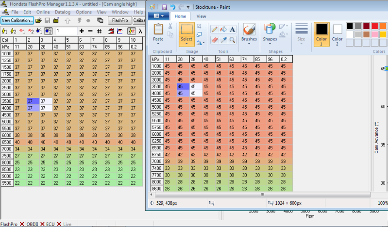

Why are cam angles different between SD and MAF
FlashPro Manager software
erik w. treves
Joined: Sun Jan 17, 2010 12:35 pm
Post by erik w. treves »
Taking a look a the tunes that are preloaded... the stock tuned MAF and SD High Cam angles are way different.... I am guessing that this is for safety?? I did notice that the mid power was up on the stock MAF tune...any ideas???
BTW I just got the tuner a few days ago and I am still trying to understand all the functions of the software....
I am liking it so far though...thank you for your product!~!
Posts: 10615
The AFM tune has 5-7 degrees more cam angle. This is not for safety - it was what made the most power on the dyno at the time.
