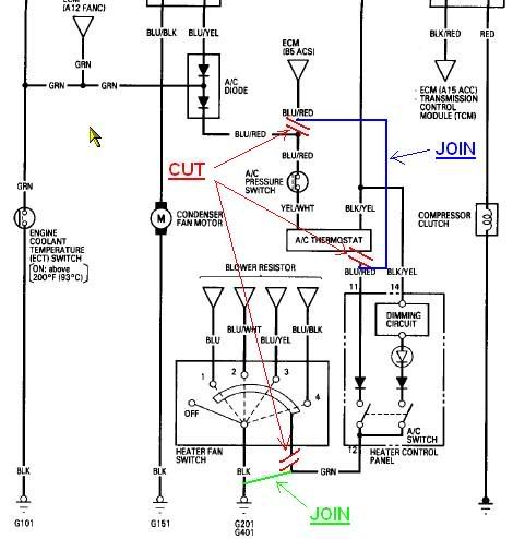

if u want to use "actual" A/C switch on climate control panel to switch inputs,u have to do something similar to the following

So if the A/C has been removed from my car (which it has, along with all the A/C specific wiring), all I really need to do is run a wire from B5 to one side fo the A/C switch, and run the other side of the switch to ground, right? Do I really need to concern myself with cutting those other wires?

Jaker wrote:So if the A/C has been removed from my car (which it has, along with all the A/C specific wiring), all I really need to do is run a wire from B5 to one side fo the A/C switch, and run the other side of the switch to ground, right? Do I really need to concern myself with cutting those other wires?
yes,well thats what removing all the A/C specific wiring does,it effectively makes all those cuts in the wiring anyway.
whatever remnants of the A/C switch are left in your dash board u just have to wire as u described.
maybe your A/C switch might have a little bit of wire still left attached to it or maybe its just bare terminals now,i dont know,but all the "cuts" have been made,u just have to do the "joins"
