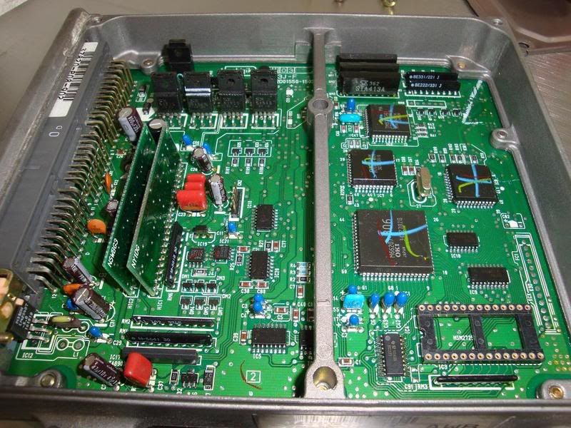

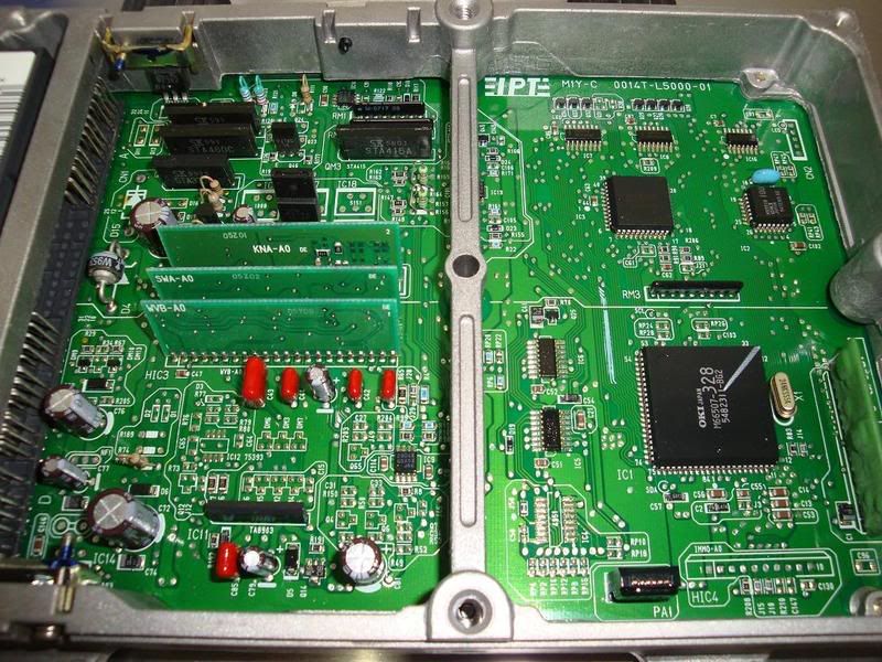

Hey guys,
I just got this 2 ECUs from a friend which he got collecting dust. He said that both were "tuned" but I opened them and didn't see any type of chip soldered on them so I'm guessing they are stock.
Would any of these work with an s300?
P2P-A31
P08-902
Thanks!
Posts: 24369
The first picture is an OBD2 ecu and cannot be used. The second ecu (P08) can be used, but only with an s300j. The s300 will not fit in a JDM ecu.
