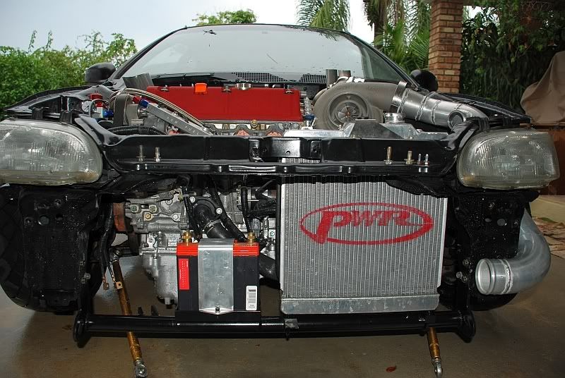

My battery voltage is real choppy and dont know why. I have a good battery and i believe my alternator is good.

Since this is an engine swap the problem is most likely related to that. The problem more than likely is with the charge harness. If the battery has been relocated, that could also be part of the problem.

Spunkster wrote:Since this is an engine swap the problem is most likely related to that. The problem more than likely is with the charge harness. If the battery has been relocated, that could also be part of the problem.
Yes my battery is relocated
and i made my own charge harness with very nice marine grade 4awg wire that was nicely put together. also i relocated my fuse box to under the dash.

Use a multimeter and check the voltage at the battery, alternator and at various points along the way to the ecu to see where the voltage may be dropping.
