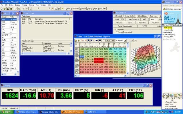

ok i got the car running using the cold air intake tune and removing the immobilizer. now i also got it running using the stock motor set up. but at the moment i do not have a primary o2 sensor. i do have aem wideband which read up and beyond 17 and i shut the car off cause i didnt want to risk running too lean. but when i run the car with open after the header i smell gas like im rich. should i wait for the o2 and double check the readings or try to add some fuel or just drive and see. i dont want to risk the motor and want.
my idle is about 1600-1700 but its also a cold start
my map was reading -16.6
and i was throwing 2 codes
-p1166
-p0141
if someone can help me out to get her up and driving around town.
