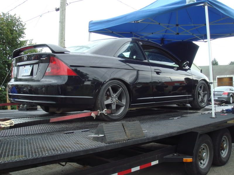

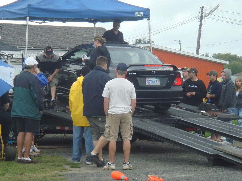

heres a few pics of my car actually on the dyno , saturday just passed. injectors maxxing at 6600. vtec set too early(5000rpm) as i learned from dynos readout , which of course you dont have street tuning.
6psi and above mentioned issues:
datalog of last run on the dyno , any opinions and advice as to my tune welcome.
