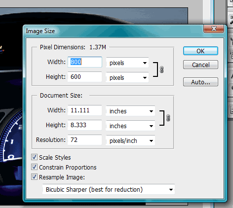

The first thing to do is get it to a usable size. I used 800x600 pixels
A. You can use what ever size you want but, You want a little bit of space around
it till your done, due to the fact that it's hard to right click and bring up
new gauge selections if you can't click off the pix. If you try right clicking
on top of the pic you will only get the pictures options.

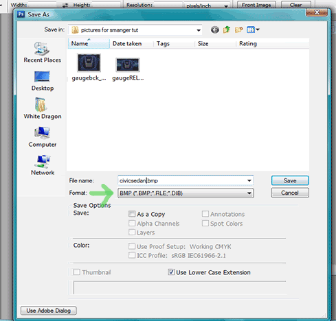

B. Important!!!! When your done editing your image. MAKE SURE YOU SAVE IT AS A BITMAP (.BMP).
(note: I know it says it takes other formats. But trust me on this one.)

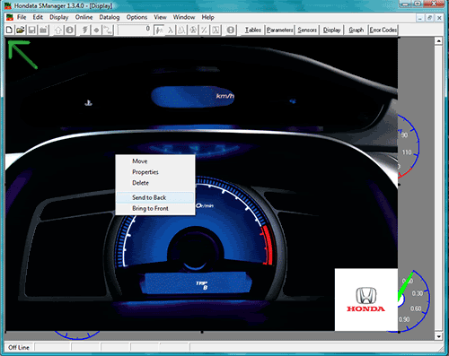

NOW INTO SMANAGER.
With Smanager started and your display window maximized.
Right click and select "new image" and pick your BMP you just made.
Once it's open go ahead and line it up with the upper left hand corner. Where the green arrow is pointing too. This will help with window resizing issues later.
You'll notice when it pops up that it's on top of anything else in the window.
Just right click and select "send to back"
From here it's pretty much just a matter of placing your gauges where and how you want them.

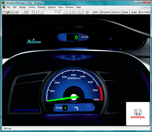

When you all done. just change the back ground color to something that matches well to your image to fill in the areas around it.
Finally, It will look something like this.
