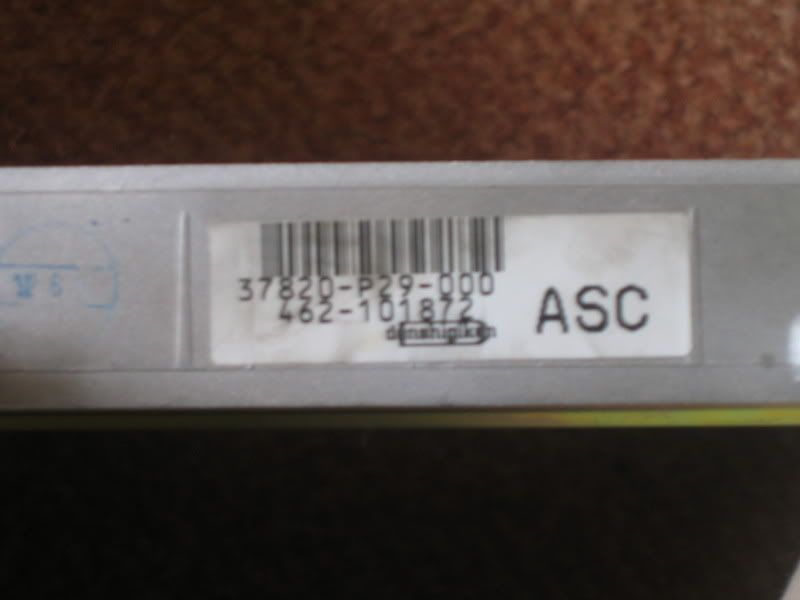

1. Can I use a JDM P29 ECU with the Hondata components? (It is the OBD1 version of the PM7 tune which is used in JDm EG5 civics to run the OBD1 dohc ZC)
2. Can the JDM square-case P29 be modified for boost control?
Here is a pic of the guts of the P29 ecu if you can tell by just looking at it.....
3. If the P29 can not be used, can i run a USDM ecu, say a P28 in my JDM car? Could I buy one on e-bay in the US, have it sent to Hondata for the boost modification and fitting and then get it mailed to me in NZ?

I think I've just answered one of my own questions....
Hondata website wrote: All US ECUs have the circuitry, but not components, for the PWM (pulse width modulated) output. JDM ECUs do not have the circuitry and cannot be used.
Looks like I either have to use a USDM ecu or an external boost controller.
What do you guys recommend?
Have the S300 do it or give the job to a Profec-B or somthing?
On the subject of Boost controllers then why are some so much more expensive than others? What can a $650 profec-b do that a $150 HDi cant do?

Posts: 24372
You need a USDM ecu or a JDM PR3 OBD1 ecu to use the s300 with boost control.
For your purposes, the GM solenoid should work fine.

Spunkster wrote:You need a USDM ecu or a JDM PR3 OBD1 ecu to use the s300 with boost control.
I can't answer the injector question as I know nothing about these injectors.
Ok so if I cant get a PR3 cheap enough is the S300 still going to work just as well in a boosted set-up with a quality external boost controller?
And is the P29 compatible with the S300? (if I forget about boost control)
I have the denso solenoid right here to use. Do you know if the GM one is earth-switched as well? because if it is my Denso one should work fine.
