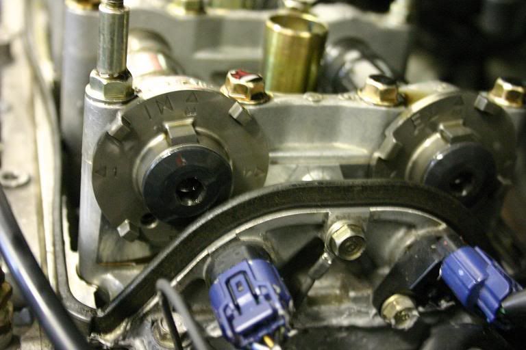

can you please explain the "parting line on #5 cap" - sorry about picture angle this is all I have
Posts: 10615
At TDC the arrows on the cams (#1 of the exhaust, #4 on the intake) should be in alignment with the parting line on the cam cap (outlined in blue in the photo).
In this picture the exhaust appears advanced and the intake appears retarded (but then we don't know if the engine is at TDC, and th camera is not in line with the cams).

I cannot thank you enough - this makes seeing if your timing is right much easier than lookin at those darn gears
