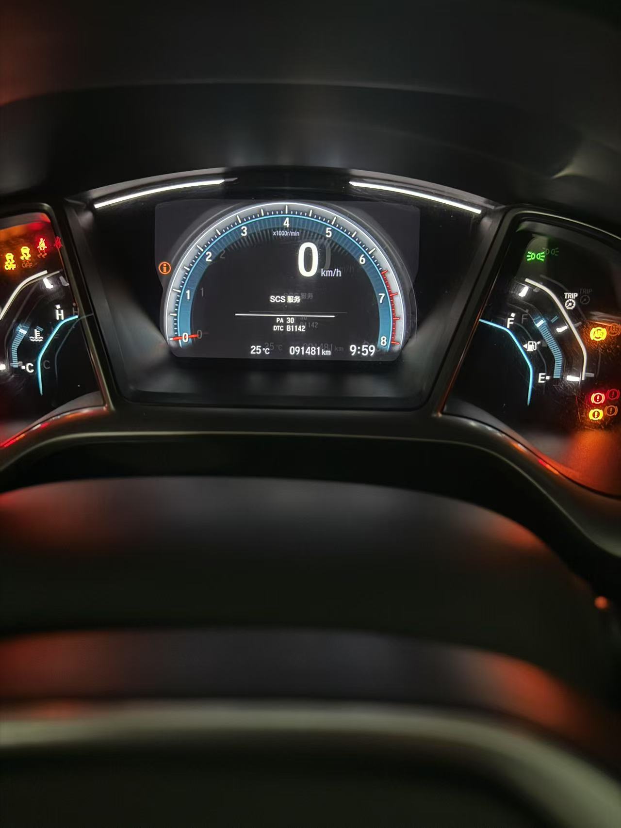

I encountered an SCS Service warning on the instrument cluster when connecting my Hondata FlashPro OBDII Interfacing Module to my 2019 Civic 1.5Turbo(2019 China). Here is the full sequence:

Step 1: Connecting only the FlashPro to the OBDII port triggers an "SCS Service" warning on the dash.

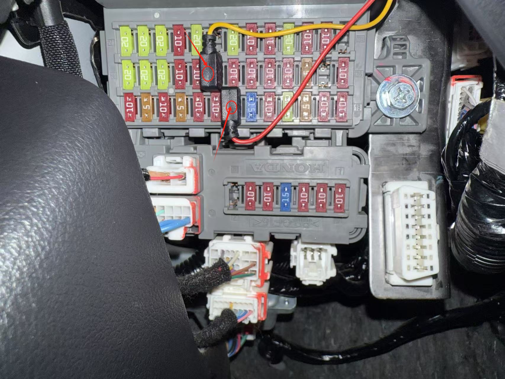

The root incident began when I disconnected the hardwired power tap connector for my dashcam from the under-dash fuse box while the ignition was ON. This caused:
Immediate instrument cluster blackout.
Transmission lockout (unable to shift gears).

Critical Symptoms When FlashPro Connected:
SCS Service warning appears on the dash.
Diagnostic Trouble Code (DTC) PA U0100 stored (Lost Communication with ECM/PCM).
Transmission gear indicator flashes with no position displayed.
Severe performance limitation:
Acceleration restricted ("limp mode").
Vehicle only operates at minimal speed.

With everything plugged in and the ignition in the on position, go to the Help menu and click on “send feedback”. Include a detailed description of the issue.
Removing a fuse cannot change the ECU programming or make it go back to stock.
You still have not told us what fuse was removed.

Apologies for my limited English; I'm using translation tools to communicate. I've uploaded a photo of the fuse I removed for your reference. Thank you very much for your assistance.
