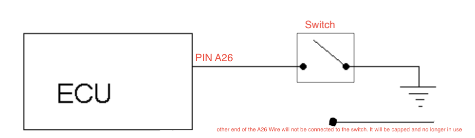

If I make the selection in KManager of "E16 Power steering pressure switch (GND=off)"
The corresponding PIN for a s2000 would be A26. Think I got that now.
One pole off the switch should be stripped back and soldered and into A26. The other pole off the switch should be grounded.
WestminsterClub
- Posts: 20
- Joined: Thu Sep 23, 2021 5:55 am
Re: S2000 Kpro Low/High Boost
Is this correct?
yes it is
