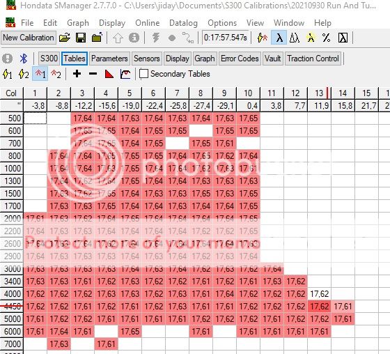

So Hi there,
first post first queestion thank for the oppotunity being a part of this community.
Here what i run.
B18B1 turbocharged,
wideband AEM 30-4110
Hondata s300
and heres my problem ;
and when we run it, it shows some good values between 12.2 12.4 full boost full throttle.
is it something to change in settings?
Thanks again,
my english kinda bad but i'm sure we'll find a way to understand each others ;)

Re: Recorded/Datalogged lambda values freezed
What input are you using for the wideband?
Post by Jiday420 »
analog0

Posts: 24376
If you are trying to run closed loop, then you must use one of the inputs on the ECU. I recommend using D10: http://www.hondata.com/help/smanager/wi ... b=wideband
Post by Jiday420 »
Why not using straighup d14? need to unsolder resistance on ECU board to use D10..?
Is there any reason cauz D14 (O2) is cancelled cauz i use a wideband,
maybe i'm wrong somewhere, but hey thanks!!
let me know what u think on that ;)
Post by TTR »
D10 allows the full voltage range when r136 and r138 are removed. D14 does not
