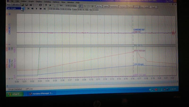

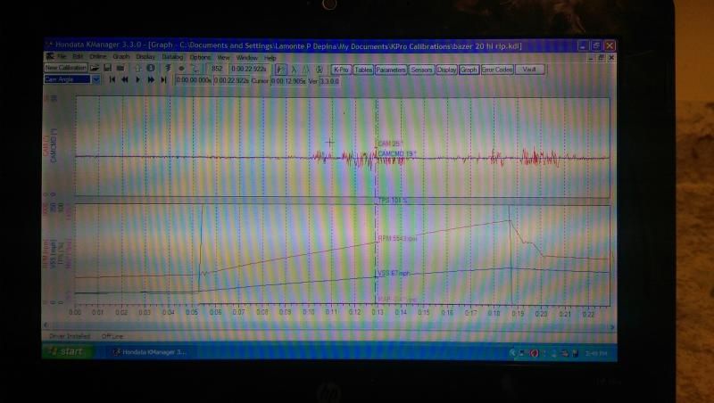

K24a2 stock 25° vtc with bolt ons. While tuning the car sometimes the cam angle wont follow the commanded angle. I have provided pics.... Becuase it is intermitent (20°hi it was doing it, and then at 30° it wasnt) pics supplied. Maybe dirty clogged sensor/soliniod? Oil pressure light has never come on. Perfict compression 06 k24a2. Thanks
No problems in 30° map

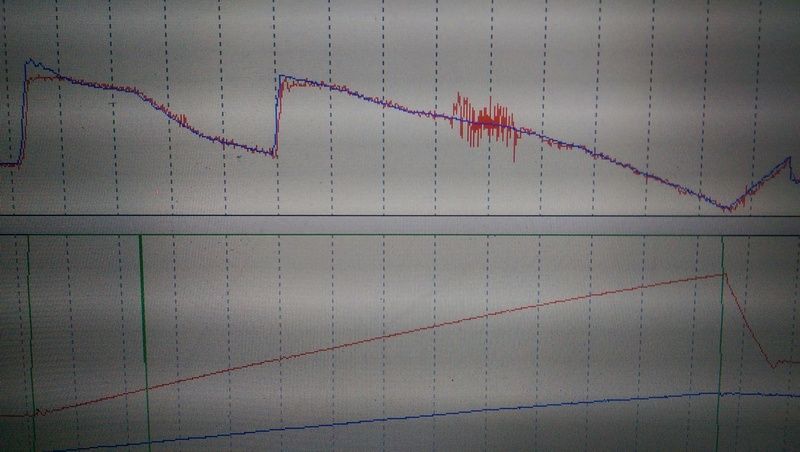

Well. Heres the story with pics, 06 k24a2 with bolt ons, kpro v2, rbc in my ep, Car pulls great, doesnt feel weird but on data logs it shows the cam has trouble following the command intermitantly at wot between 4500-7000 rpms. It only happens for a split second and comes right back to were its supposed to be. I have been playing with it for a while and so far have changed or checked these things
New grounds
oil pressure 30 psi at idle 80 at wot
tried different maps
Im starting to think my vtc gear is bad... Idk what else it could be. If timing was off a tooth wouldnt the car run like shit and throw a cel? Or look crazy in kpro? I never see below -1°. maybe the ecu? Sensor? Why would it be intermittant and why dont i feel it in the power band? Anyone please help :)

Check and clean the VTC filter in the cylinder head. The next most likely problems is the VTC solenoid and then the VTC itself. Finally it can be a bad connection in the wiring.

I know this is a blast from the past, but wanted to provide the info in case someone else is having the issue.
I ran into the same problem as OP, and went back to look at old logs to see it wasn't doing this. My issue was the oil was almost near the lower dot on the dipstick. I added a bit of oil, and the vtc scribble lines went away. Hope this helps someone.
